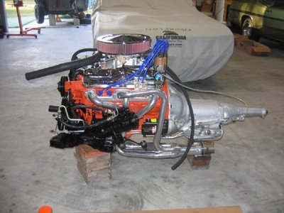

Here's what I pulled out
Wasn't bad, but the header definitely had to be loosened up
