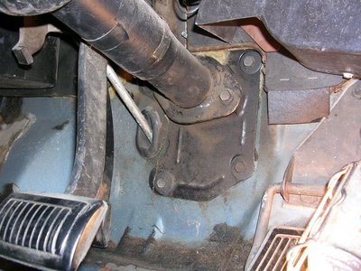

Need some help again, lol, the main plate for the steering column that attaches to the firewall, does that plate have bushing or something to fill the gap in the large holes? Can someone pop a photo for me on how the plate attached to the firewall, thanks.
you could check in the tech section here, the FSM for '69 is there, but IIRC there is just a foam gasket and the plate has three bolts to the firewall.
quikbird
3,233
1,028
Sarasota, florida
There are two plates, the big one attaches to firewall and needs a foam gasket, I think 4 bolts, the second plate attaches to the first plate and also has a gasket and seals column to first plate
"That picture is missing the clutch rod boot"
nobody asked you and he was asking about the steering column....:elmer:

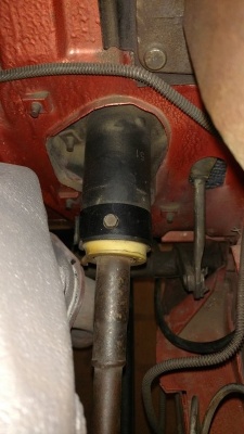

Can anyone help me out with a picture of the steering column attached to the firewall taken from the inside of the car?
