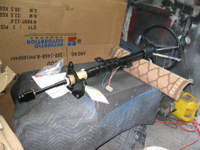

Here is pic's of it painted and ready to put it back together. Just waiting on the Knuckle parts to come in then can finish putting it back together. Hope I can remember how it went. LOL. Have a new turn signal arm. IMG_0101 (3).JPG IMG_0102 (3).JPG

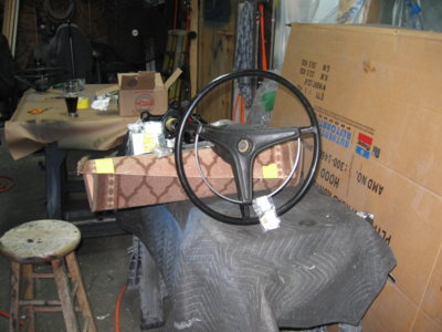

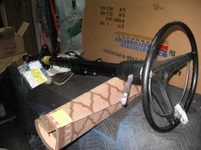

So here is the finished product. Ready to install in the car. Rebuilt the steering knuckle. Notice the red rubber. Swapped the steering wheel for this one mine was all cracked up. new lower bearing. Also new turn signal switch. Could not use the metal piece that went to the turn signal handle then to the switch. The had a plastic piece for replacement. Tried to get it out but did not want to force it and brake the new switch.

Oh you noticed that did ya. The best looking thing on the column. LOL. Did you get hooked up on that horn button cover. Hope it work's out for you. Russ.

That really came out sharp. I did not rebuild the knuckle. I think mine is ok. What is in the glass that is half full!!!!! LOL Big Mo.

Coke Cola. In the morning drink Coffee till about noon. Then switch to soft drink. Then late in the after noon might have a beer but not always. LOL.

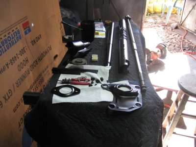

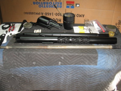

Russ you said you rebuilt the knuckle. I looked in my parts manual to see what is in there. What all did you replace or repair. Also the bearing at the bottom of the shaft is smooth when I turn it. Big Mo.
New pin- shoes- and the top rubber seal with holding bracket. Put new grease in it. Around the end where the bearing is the guy on U tube put a strip of peal and stick foam for a bottom seal. Just to keep dirt and such out of the bearing.
