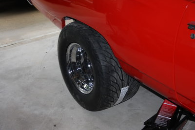

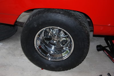

Picked up the one new rim and tire and :eek: :eek: :eek: they are huge. But they will fit :banana: :banana: :banana: Later today I am going to put it on one side at a time and measure to see how much I will have to narrow the axles. My bet is 2.5", we'll see when the tape comes out.

Here's the start. Have to narrow the housing by 3 inches. I put this one tire on for a measure test. Wow are these things huge. I've ordered new Moser axles and will do the housing myself...which I will photo-document for all of you.

If I leave them sticking out it becomes a double cop magnet. My buddy with a coronet was busted and had his car impounded by the cops for 30 days plus $800.00 fine for having the wheels stick beyond the fender line. Don't think I want to try that.

yeah its not the look stickin out like that......how much room do you have between the inner tire and the spring??

I'll have to measure...with the tire the way it is I think it is about 5". Once inboard there should be about a little under 2".
