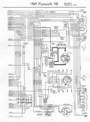

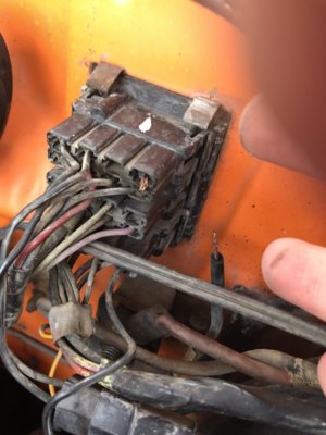

That looks like the fusible link.
Feeds everything inside.
If the wires are good, you can get 56 type "Packard" connectors and replace each as necessary.
The trick to removing the old male connector from the plug is to snip the tip into two pieces with dikes from the face of the plug.
Each side section will then come out.

View attachment 28890 Never changed one on road runner but autos also had fuse wires once upon a time. Blended right in with harness wiring and usually resoldered in place. They would burn up, different colors determined amperage.
This was a piece of wire itself not an inline fuse with leads. Try to locate info. Only thing I could find was fuse link as part of starter relay circuit. Mechanics hated them. Here it is- https://www.amazon.com/s?k=fusible+...=t&hvqmt=e&tag=mh0b-20&ref=pd_sl_4oj1w8rt09_e
