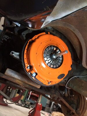

I’m running a centerforce diaphragm behind my 6bbl and 18 spline, 3:54 rear. It’s a great setup, tho some may not like the diaphragm style, I find no problems.

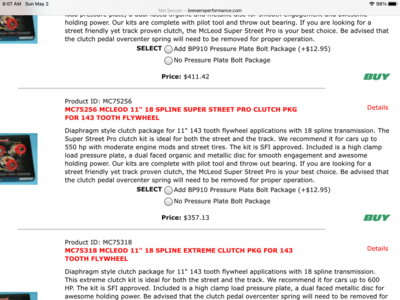

Looks like a really stout diaphragm clutch plate. That should do the job fine.
Bought it from Mancini because they’re only about an hour away from me. I did buy all the other rebuild stuff from Brewers, because Wayne helps me on a lot of stuff, and I sell all my extra 4 speed stuff to him. Everybody got a piece of cake from me, and I got a sweet setup!
