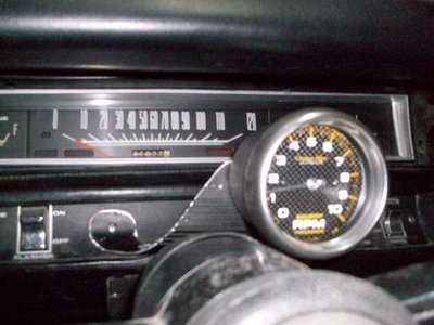

I am having a damn hard time removing the switch bezel. The four front screws are out and have looked back behind to see if there is additional screws securing it to the dash. Any hints, what have I missed. I fabricated a bracket to mount my Tach to and I plan on routing the bracket behind the bezel securing to the two middle screws.

They come out hard,I had to remove the switches from the back side on mine to get it off,especially the dashlight dimmer.As the dash pads get older they are less pliable.
I put a screw driver behind the curved end of the panel so there are no sharp edges as you pry it out and put some rags or padding over the dash pad you are prying against. It all depends on how hard it has become

I had my dash on a table in the cellar and I still could not figure it out. If your having the same problem as I did, it is the dash light dimmer hanging up in the metal hole of the dash and it is extremely tight. If possible, reach from behind and move around with a tiny screw driver. With the front also being very tight from a very old dash, have someone move the outer while you move the inner. It will be as co-operative as a piece of bird-ox on a fleece sweater!

The screw driver will work just go easy and yes patience. It will come out. The switches will stay in place.

One more thing. When I had mine out I found that there isn't much extra length on the wiring harness to each switch. I found that I had to disconnect each one as I went and I had just room to get my hand behind the panel to disconnect the plug. And they can be a lot of fun to put back together!!!
