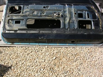

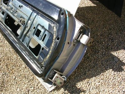

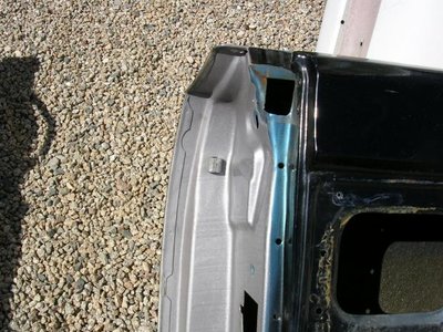

Hi all, getting close to paint on my RM23, and my body guy needs to know where to tape off my doors where the exterior is T5, and the interior is T7. My guess was at the door seal/weather strip holes around the perimeter of the door, but he thinks it might just be a tape line around the interior panels above and below the door panel.

disregard the silver paint the blue is factory. Changes at the weather strip

THANK YOU SIR! Fantastic detail pictures!
I see three colors though; Black (interior), Silver (exterior), and Blue (separating the two). Was the original exterior color blue? Or was the original Interior color blue?

His car was originally blue, was repainted silver, and is again wearing blue on the exterior after a complete nut and bolt resto. The car has a black interior.
If you just mask it off at the holes to attach the weatherstripping you'll be fine. The transition point just has to be BEHIND the weatherstripping. This is not a precision operation by any stretch of the imagination...
