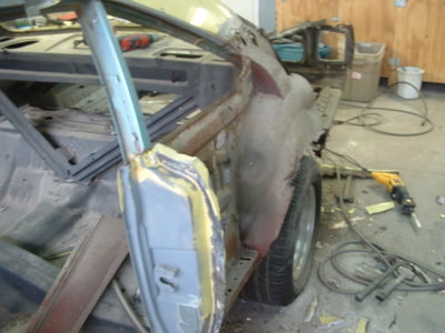

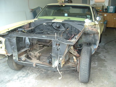

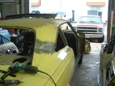

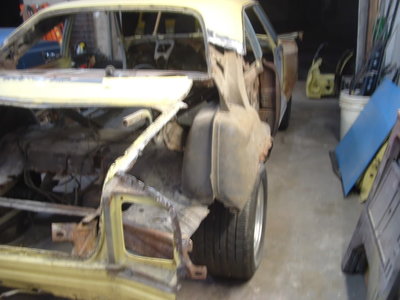

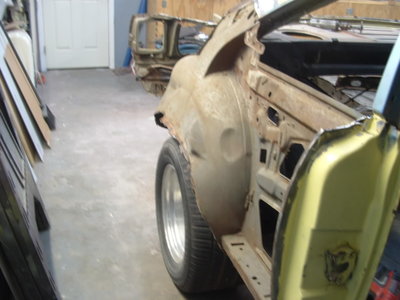

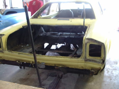

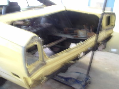

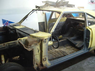

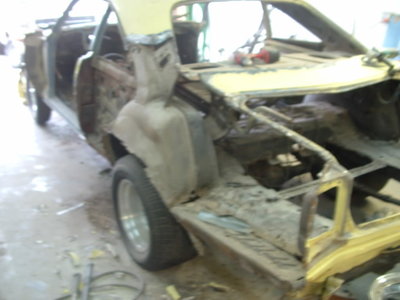

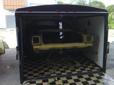

Tear down completed and off to blaster today.
JJRJR
Sep 3, 2011
696

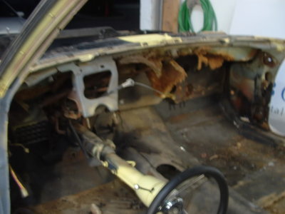

Off to blaster today. Turns out that this thing was a rust and bondo bucket. Got robbed on the purchase, but I love her nonetheless. Much more $$ that I had thought, but can't turn back now. Going with Q5 Seafoam Turquiose and all white interior.
10,552
308
WOW! That's a lot work there, but it sounds like you have the right attitude to get it done. Good luck!
JJRJR
Sep 3, 2011
696
Sure is at least twice what I thought it would be, but it's 42 years old and she shows every day of it. I think it was stored at the bottom of the ocean for 10 years or so. LOL. Anyway, it will get done and I'm sure it will look awesome when done. Not much of the original sheet metal made the cut, so had to replace floor pans, trunk pan, both quarters, wheelhouses, all the suspension, leaf springs, shocks, brakes, etc. Pretty much will be better than new.
Also having frame connectors and torque boxes installed and got the hemi leaf springs. Eddy shocks and all Poly bushings. May have to return the power disc brake kit and go with standard disc non-power assisted due to vacuum issues, but we'll see.

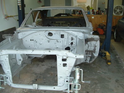

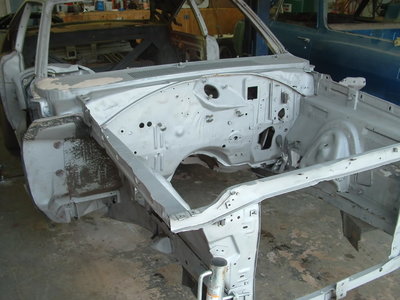

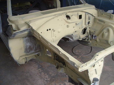

Thanks Barry. I'll be posting more pics later today. Car got back from media blasting and it looks greast. I think we may have to go with a vacuum pump and see how that works. The guy doing my car things he'll be able to get it to work with the pump.
I'll also ask about the poly bushings; this is the first I've heard about them getting noisy, thanks for the tip.

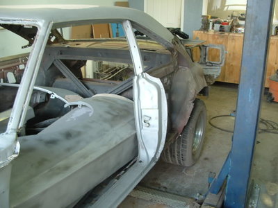

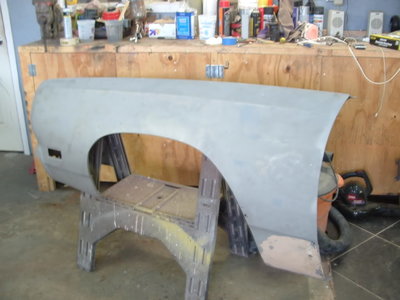

Media Blasting Done. Time to put Humpty Dumpty together agai
moparchris
Feb 8, 2009
4,814
40
costa mesa ca
If you change your cam specs a bit it will have plenty of vacuum. Just widen the lobe seperation out to 112 or 114. It will smooth out the idle too and spread out the powerband allowing you to have a tighter torque converter and run less gear. Choppy idles and high vacuum reading dont exist together. Well unless its 600 inches then all bets are off.
