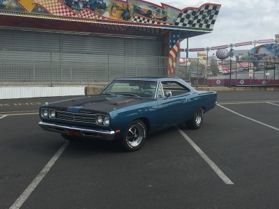

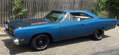

I am running 275 60 15 on a 15x8...I was running black steelies for a while and now have magnum 500's. this is all on stock suspension.

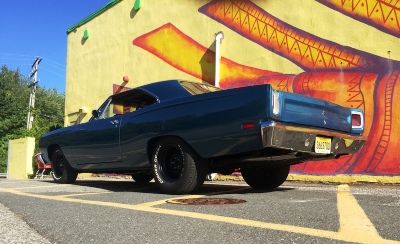

no sir. I went 15x7 up front with 235 60's no rubbing anywhere. I did replace front/rear shocks (rears are Monroe load leveling).
