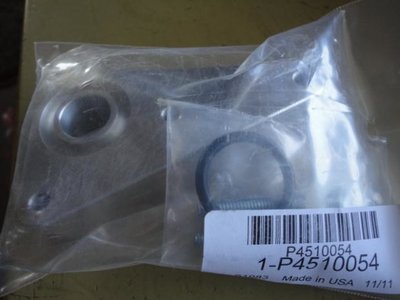

MP has new solid spacer...
I just bought the Mopar Performance deep 727 transmission pan package P/N #P3690730 and it came with the solid aluminum spacer and small parts package P/N #P4510054. The spacer and parts package was the only part of the pan package that is made in the USA. I bought the Mopar deep pan package from Mancini Racing. With the moparts.com discount, it cost $76.15 including shipping out the door. The complete pan package also comes with Mopar ATF filter and gasket.
