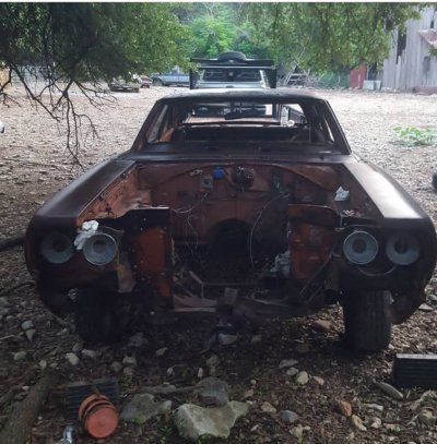

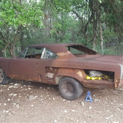

Well as some of you know I found what looks like a dead 69 Roadrunner but turns out to be a preaty solid car. Only crossmember that needs work is the shock crossmember. Yes there is rust that needs work but we are already on our way. We verified vin#'s as the lynch road fender tag did not match. The radiator core support and dash tag match, next it is a post car and the fender tag was for a non post.

I was shocked that the wiring and connectors look very good. Our next plans is get it back on 4 tires, treat it with Ospho for the meantime and gather the parts to resurect it. We will be doing this on video for our own memories but will also post it on youtube. Plan is running and driving, go to a dragstrip and then roadtrip home.
Once that is complete the Ospho will be removed and SPI epoxy applied per thier instruction with an eye at getting the body where it needs to be for a driver quality paint job and restoration of all the remaining systems. Hope y'all enjoy.

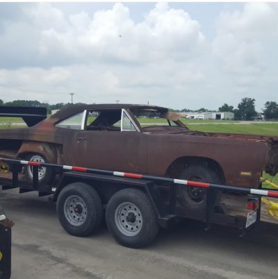

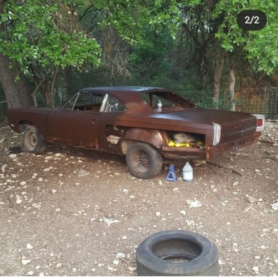

On the day we were able to finally take it home (long story) we arrived to find that the hood, hood hinges, latch support and grill header panel (forms the upper part above the grill and the secondary latch catches there) had all been unbolted from the car and stolen. I have since bought another set of hinges for $40.00 at a swap meet.
We found the passenger side front brake drum frozen up (still is). We installed 2 rims and tires on the front and pulled it out of its grave with a front end loader.

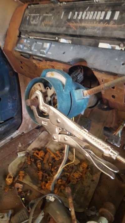

Due to the problems of the lack of a steering column and a frozen drum we used 2 sets of vicegrips on the steering coupler to keep the tires straight.
Once we were by the trailer we installed the explorer 8.8 rear in it. I had the foresight to get the correct size u bolts, spring perches and shock/spring plates ( bought off member on FABO) to do the deed. Now on 4 tires we loaded it onto the trailer in reverse. The trip home was uneventfull but I should have remembered the front seat even though the drivers seat back was MIA.

Once at the house I jury rigged the power stearing column into the manual steering car and managed to get it pulled off the trailer. We then cleaned out and cataloged what parts were in the floorboard.
After removing the fiberglass patches on the roof we proceded to apply Ospho over the car and any of the interior spaces that were exposed to the elements. This was done for 2 reasons, 1 stop the rust. 2 SPI urethane lists it as the only treatment that would be compatable with there product after a prep process.

Since its not a #'s car this was the most inexpensive 15" steering wheel I could find. Special vicegrips on the column just arnt a good look. 20210909_153423.jpg

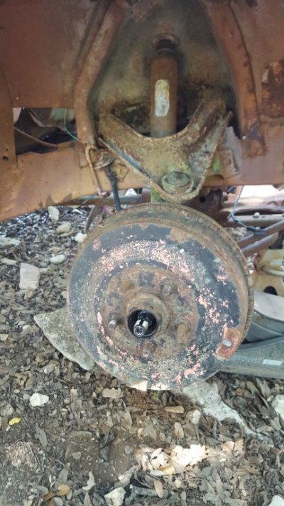

I then went to work on the frozen passenger side front brake drum. Ended up having to use a cold chisel on the retainer pins in the process. 20210908_141313.jpg
Turned out the wheel cylinder was still in tip top shape including the seals. Future plans include disc brakes on the front. Invencible Extremes Muscle Cars makes 2 different disc brake conversion brackets. One works with 03 and up 13" and bigger mustang calipers and rotors, the other uses 94 exploder 4x4 discs and calipers to work with 15" rims. I am going with the 15" rim setup but have the bigger setup for my sons 67 Coronet.

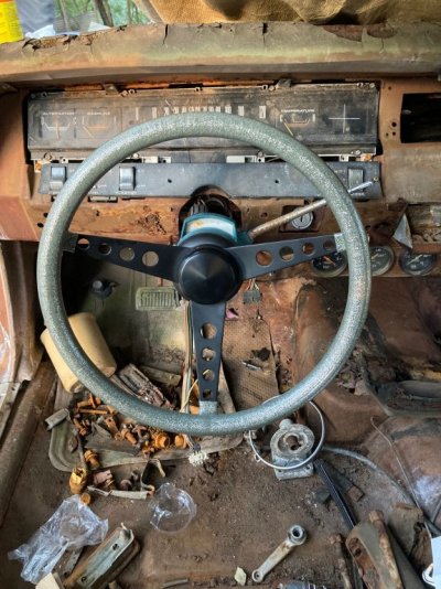

Ordered the powersteering column to manual box adapter so will get the column in properly in a couple weeks.
