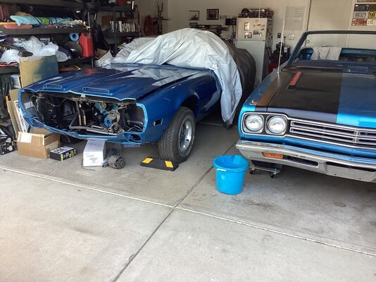

Spent 3 hours today on the formula now I’ll do three more on the roadrunner.
Summer heat in Az certainly slows any real progress. Then I’m out of town for 2 weeks again.

Heat yes.
But it looks like you suffer from the same as me.
Lack of space. I spend time moving things around to work.
And of course, no lift.
Lack of space also causes things to get lost.
This car I built a dedicated car parts storage shed before I really started disassembly.
But still had to use my house for things.
And the shed is so cramped I'm wondering why I can't find the original seat belts.

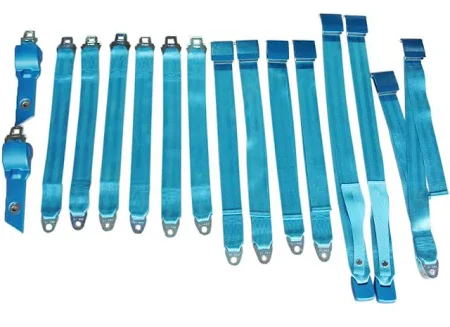

May not want to find those. May not be safe to use. They deteriorate with age.
ww.69roadrunner.net/mopar/threads/1969-plymouth-road-runner-3-speed-auto.17963/#post-198423
I've already bought new ones.
I need the old ones to compare unless someone can tell me the length.
The only ones being sold that are near correct state "for show use only" and they are too sort I think.
China strikes again.
For some reason I was able to find my 2 shoulder belts from the headliner.
Guess I took those off later in the disassembly.
And they are fine.
But I don't think the lap belts are long enough.
(It looks like other people are having the same problem. )
I can't put the seat in the car just to check.
What I'm thinking is that I'll send the lap belts out the have longer webbing installed.
This is the only one being sold that I could find that has the correct clips.
Everything else has a different system type of clip.

I work for the company that made the originals (American Safety, now AMSAFE). I have searched engineering archives for the original blueprints but they are gone. Still have some of the square buckle designs though. On the old original belts, I did a tensile test on one. Think the spec is 3000 lbs. my 1969 baked belt broke at 3200 lbs. and it was a buckle failure not even the web. I still wouldn’t use the old ones though.
