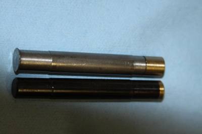

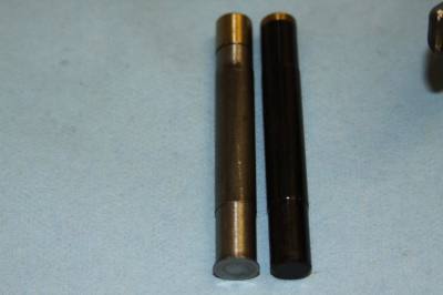

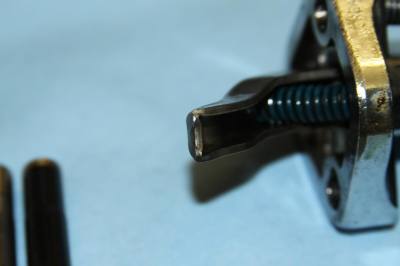

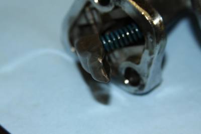

This not at all what I was expecting. My Runner wouldn't start last weekend and it was clearly fuel as the carbs were bone dry. I kept taking stuff off and really couldn't see a problem. I have an electric pump on the back in-line with the mechanical pump so I thought I should be golden. I recently put a vapor separator on to make it look more factory and it seems the electric pump was just pushing fuel back into the return line but couldn't push it to the carbs on it's own. So thinking about it I wondered if the brass tip on the fuel pump pushrod could have worn down and so the mechanical pump was no longer working. I ordered a new pushrod from Mancini that came this afternoon. After taking the pump off and removing the pushrod, I found what you see in the pics. The brass end looks good but the pump end is mushroomed like crazy. Also it looks like the fuel pump arm is worn down significantly but it is hard for me to tell since I don't have a new one to compare. I don't know what to think about this nor how to fix as that side is clearly not getting oil. Any thoughts from you guys? Also it looks to my eye though I haven't measured yet that the new pushrod has a slightly smaller diameter. Does this matter? I may post this elsewhere to see if anyone has any ideas.

The push rod only looks a little shorter and I would think it was still pumping something.The narrower pushrod will be ok unless it is more than .005 smaller.

Jack it happens, your rod has gone soft :lmao: Are you running an oil slinger on the crank? I think that's how they get oil and Ive seen threads on other sites saying they are not needed with todays seals like all they did was keep oil away from the front seal. That should have still pumped fuel, but if mine sets for a week the carbs go dry and the fuel line from the pump to the carbs empties back to the tank through the return.

That happens a lot these days. :huh: I have sure seen much worse so I am a little surprised at this. There is maybe a quarter inch chewed off the rod which doesn't seem like that much compared to a pic Stu posted on fbbo a while back. I will put it back together and see what happens. I am wondering why the electric pump didn't push fuel up to the carbs on it's own. I didn't put a filter back there so I wonder if a piece of debris got picked up at the pump inlet.
