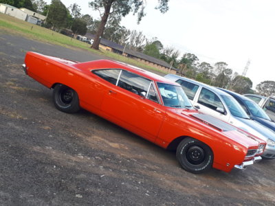

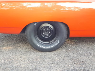

295's in a 50 series will fit on a 15 X 10 rim no problem (26.7" overall diameter), but I think you'll be punished with the taller rim if the rubber is too tall, as the top of the arch rakes in real quick.
Im currently running the 275's in a 60 series (28" overall diameter) and ive got no issues.

Rknrlr, would you have a side shot picture of your vehicle handy? I'd like to see what the stance looks like with the 60 series. Also, you have the 275s both front and rear with no issues?
Thanks,
Jack
RKNRLR
Mar 27, 2017
705
653
Sydney, Australia

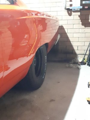

no, ive got 235's up front, theyre the smallest tyre that'll go on my 8"rims. lemme see if i can find a photo here somehwere

rear 15x8's are 4.5'' backspace, I noticed there was more space in the inside to the leaf springs than to the guard, so I thought why not.
I also ordered a set of 15x10's with 5.5"backspace, but haven't been able to find rubber for them yet. Need at least a 295, but I dont like the BFG's in the 295/50 series.
Had a set of rally wheels made up a while back, 15x10's for the back, and he put a 5 3/4"backspace. All measured off stock rear suspension components.
