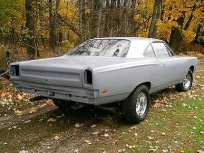

I suppose that many threads have been done already, sorry for that, but I'd like to know if one of you running 235/60/15 up front with manual steering? or bigger size?
Any feed back on that would be appreciated guys :)
Is that too hard to turn when parking or ride at slow speed?
For my bird I'd like to go with Aero wheels ==> 255/60/15 rear, front I don't know yet but I'd like to go with 235/60/15 if it's not too heavy for the steering box either.
I have 2257015s on my front, manual steering. my car steers really easy.

Can't help you on that cause I gots PS... BUT for stance I am running 235 60 on 15x6.5 fronts and 275 60 on 15x8 rears

15x8 with 4.5 backspace is perfect. I would run 275/60 on it too. I run 235s on my T/A Challenger with manual steering and its livable.

thanks Moparchris for your message, I was thinking of 275 but i wasn't sure about it, but now i might reconsidering my choice lol! So lets do this 235/60/15 up front and 275/60/15 rear perhaps.
Also i post on FBBO for aero wheels choice etc, and they told me that are only race wheels and "not DOT approved" what does it mean?
I can't run those on an open road?
not DOT (Department of Transportation) means at least in the States they are not legal for regular road use. You would have to check your local laws. I have 2756015s on 15X8 on mine.

Only one problem now that I know everything I wanted thanks to you all, but I checked and I just saw with those rims 4.5 inch back space doesn't exist... :(
Is 4 inch back space will work?
