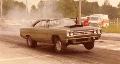

8 3/4 with 10.5 slicks. Never broke it.
Pic is from the late seventies and the car was about a half second faster.... I musta been playing games with the clock that day.
