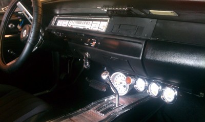

The AC stuff takes up a lot of space and I thought I could delete it. My donor car was an ac car as well so no luck on replacing it with a non ac unit. I am not worried about being "correct" bc it's a non numbers matching car anyway. I do want it to look right.

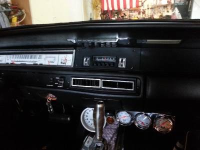

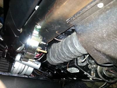

You could delete it, I have a 68 delete plate for the center vents if you want it. I just put it all back in even though my ac is long gone, with the hopes for after market ac some day, I even got all the controls to works right with vacuum etc. blos nice hot air through the vents now lmao
Before
