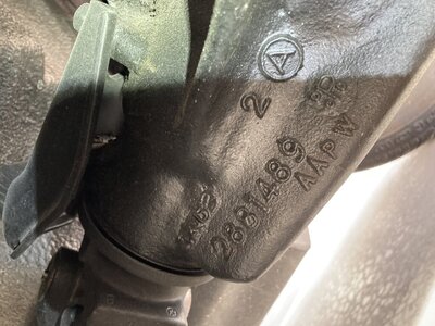

Can I find that out by numbers on the fender tag or markings on the differential ? My guess is limited slip.
7,827
3,407
th (2).jpg th (3).jpg You will find marking's on the chunk like this. X for 741- 2 on the 742 Then their is the 489 Three types. I rebuilt my 741 new ring gear and pinion. But still some slack in it. The spider gears are worn also. But going to run it till I can put the other chunk in it I got. Even the spider gears can give you a clunk sound. Going forward then backing up could give you a sound.

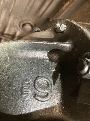

Have you tired to Google those numbers. Several Mopar sight's to look into that. That 9 is throwing me off. May be the rear end has been changed out. Sorry not much help I guess. :(

Yes sir, i believe a lot of parts have been changed out on this RR. But I will probably always be guessing on that unless I dissect the vin and fender tag with engine,tranny and rear end numbers. It doesn’t matter to me very much, just want it all to work like it should.

Yes sir the idle is down within specs. But of course when it’s cold on a first trip of the day is when it’s more pronounced. Has anyone figured out my rear end numbers...my guess is limited slip. Some research would indicate with that 489 number that it is heavy duty...which is nice!
