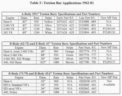

Do you guy's think that the one's I have will work fine with this 383 I have. I stood up in the front fine. It was the rear leaf spring that where bad Russ.
Yes - if they are one's that came out of the car. Not sure just how disassembled this thing was when you bought it. You should have part numbers 1857778 (R) and 1857779 (L) if you have the original ones.
