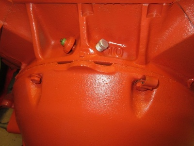

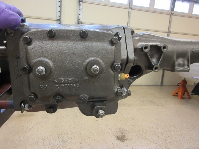

Two clips on the side cover above the reverse light switch and one on the bellhousing. Swiped these pics off of FBBO.
