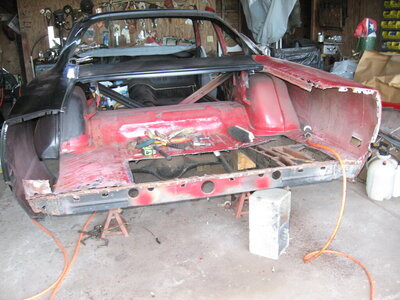

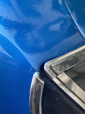

When the new quarters were put in it some 15yrs ago do they weld these in top to bottom then get out the body filler(bondo) and smooth it all out? Does the new quarter get welded in at the seam where the quarter meets the rear deck?
7,704
Yes it meets the filler panel. Then goes up to the roof line where the sail panel and quarter meet. What they did is what a lot of shops do. It is not as much work as replacing the hole quarter. You will have to take it loose from where the roof over laps it. Cut down the window channel. Then the corner filler will be replaced also. Take the trunk drip rail loose. Tail light bucket will be taken off. Cut out around the finder. It goes all the way to the door latch pillar. It is a lot of work. So you can see why they cut into the line on the out side and stich it in so to speak. IMG_0101.JPG
