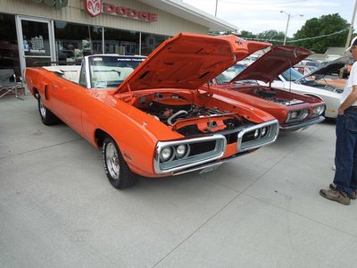

My buddy has this 70 coronet and runs the power tour every year , has had the tremec in it for over 7 years now
he loves it and has over 45k miles on it now , believe me he beats the shit out of this car also
and it keeps running like a top , he has gone though two clutches already :D :D :D
damn defective clutches :lmao: :lmao: :lmao:
Mike Meads I run with him to lots of car shows
