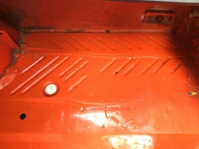

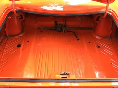

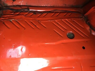

I have been looking for a 70 Roadrunner for some time. I am very close to going to see this car in person and pulling the trigger. I know a lot can be learned from looking at the trunk area of a car but I’m just not that educated in this area. Anybody see anything troubling here or does all look 1970 legit? Thank you in advance.
No. Not yet. Looking at it in person tomorrow. Guy has a lift and said I was welcome to inspect every inch of the car while it was up.
Check around rear window and front windshield where A pillars are. Look at the lower cowl in car. Look at the drop downs around the wheel well's and the rear tail panel area. Check cross member and all the struts. That dose not cover it all it is a lot to look over. Like rocker's - bottoms of doors. Front fender well's. Take a good long look. Might take a magnet to check for bond o. :thumbsup2:
Well are you just buying the trunk or the rest of the car come with it. Heh heh just kidding big guy!
Well, good question, lol! I feel like I have a fairly good understanding of good/bad bodywork, panel fit, paint quality etc but it’s the trunk area that I always seem to learn from people. Going to see the car today. Hope to be bringing it home. I have looked at a few turds recently so hoping this is the one!
