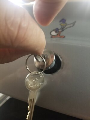

So I was at the house after going to a show and started to unlock the trunk. They cylinder came out looks like something broke on it plus the nut on it came off. I'm ordering a new one but until then I want to put the cylinder back in. I cant seem to get the old nut back on it. Help.

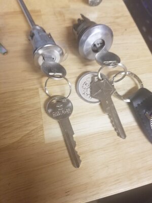

Help. I got my new trunk lock from classic industries. It's too small and according to the company it's the one for a 66-72 mopar. PY012B. WTH?
That suck's. They don't look the same at all. Wonder if some one switched the lock at some time or another. Mine for my 69 look's like the one they sent you. Maybe some of the other guy's will see the old one and explain why they are not the same.
The problem is not the lock. The problem is the hole has been enlarged somehow. There should be a dimple in around the hole for the lock which is not present in your pic.
Did not want to say that but look's like it had been punched out the old lock and cut a hole to put this lock in. Mine had been broke into and the hole was messed up some but was able to straighten every thing out. I agree with quikbir
Chrysler switched to the nut style retainer in the late 70’s and it is bigger in diameter. The hole on your 69 deck lid was drilled out so your only options are to weld up and repaint the deck lid or get another of the later style lock. I have seen them on F bodies and I had a 78 New Yorker that had that style of trunk lock. So I would say any 76 and up Chrysler product would have the style lock you need.
remember that the original lock is recessed into the deck lid a bit and must be in about the same place for retention clip to work. no idea how flexible the later model lock fits
