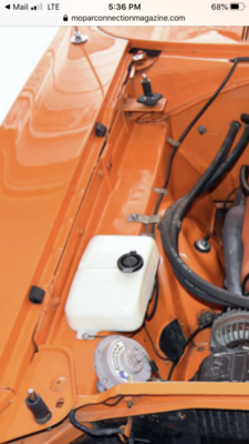

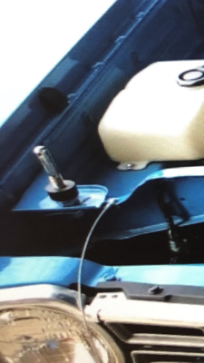

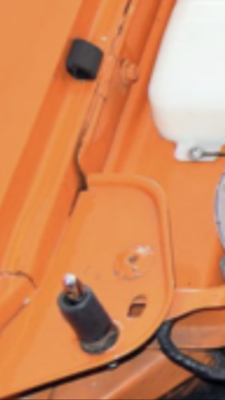

It appears the front area where the pin is located is different on the 69 than the 68, take a close look at the pic. Of the orange 69 and the blue 68 it looks like a different piece of metal was used between the two that the pin mounts to.
