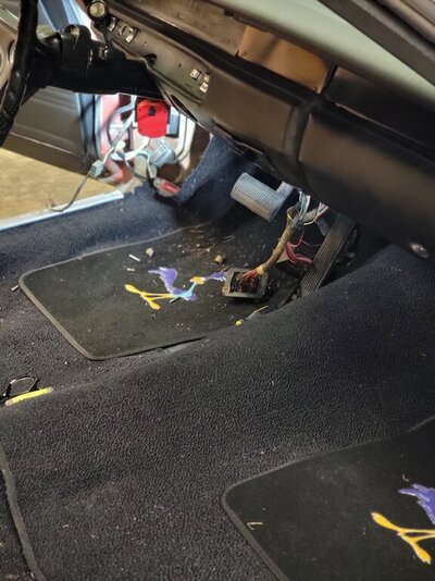

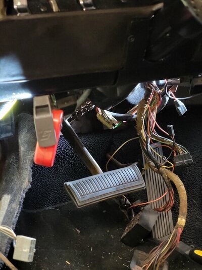

Well not good news. Would not start. No spark to the plugs or no power to the coil. Car turns over fine.
New engine wiring harness
New under the dash wiring harness
New coil
New ECM
New fusible link
Distributor? Rotor button? I'm gonna check that tomorrow.
Grounds? I've checked them.
Ignition Switch?
Alternator? I did put a new one on and the wiring harness was for the new flatback style.
I'm tired started this evening at 6pm.

Man I'm sorry.
7,705
Stop take a deep breath and think about it. Check at start run relay. Wires from your new harness. So, to say now no more of those splices in your wiring makes for a clean application. Your getting there and will feel a lot safer with the all-new wiring. This was a good move by you Russ. From one Russ to another. LOL. :thumbsup2:
Carl Ray
Aug 3, 2020
67
Do you have 12 volts at positive side of coil? If not, work that problem using the wiring diagram. Also, if no 12 volts at coil you can run a temporary jumper wire from battery positive to positive side of coil and car should start and run. Key word is temporary.
Russ Hood
Jul 23, 2020
399
407
TN
With a electronic distributor?
