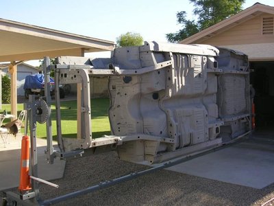

Depends on how much undercoating there is...
Probably two bottles will do most, if not all.
