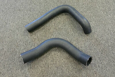

I am trying to locate and upper radiator hose for a 1969 Plymouth Roadrunner. I am trying to locate one at the local part stores, but they do not seem to be able to find one that will fit. The ones they have are completely different. Does anybody have a part number or maybe used one from a different vehicle that will fit? The one I need has the passenger side Inlet it looks like the upper hose in this picture.

You probably won’t find one. Take a coat hanger and form it to shape you need. Then take that to store and just find a hose that has the curves you need. Might be bigger than need, just cut off extra parts

I ended up finding one. The hose I got was from Napa Auto Parts # 7602.. Napa seems a little more knowledgeable with older vehicles. I ended up trimming off about two inches but it fit like a glove. Thanks for all the help.

I got mine from O’Reilly Auto Parts, but mine is on the drivers side. I think I had to trim the long leg a bit for a proper fit.
