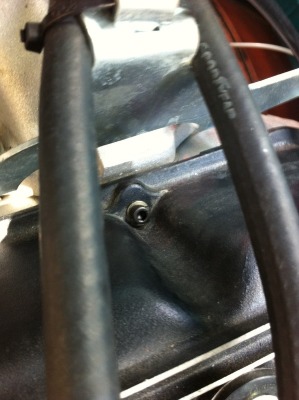

Hey guys, was finally able to get the hex bolts off the MP covers, slowly and painfully. Ordered these bolts from Fastenal and they work great. Replaced the cork gasket with a nice composite from MP and not a drop of oil now. Finally!!

Only way to go with the hex head bolts.
They have been on my race car both valve covers and the headders and never have to retighten them. :yesnod:

they sell the ball type allen wrenches if you can get on them straight.....also on sockets.....works very well

Hey JJ got some part numbers for those of us who have similar setups?
Hey John, yes. See below, got them at Fastenal.
SKU QTY DESCRIPTION QTY PER PKG PRICE EXT. PRICE
23207 15 1/4"-20 x 1-1/4" Black Oxide Alloy Steel Socket Cap Screw 1 $0.1862 $2.79
They work great, easy to get to for tightening, etc.
