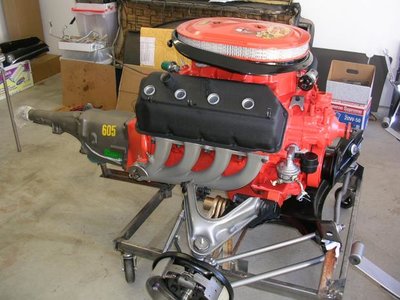

yeah but you got holes in your valve cover that RTV won't seal......
Actually I could probably eliminate the valve cover bolts, the spark plug tubes add pretty good pressure to the cover :blah:
