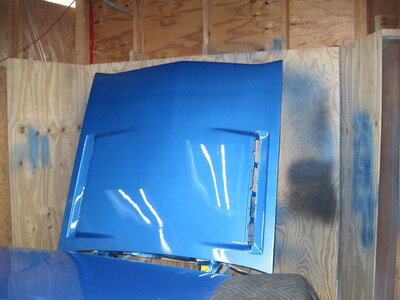

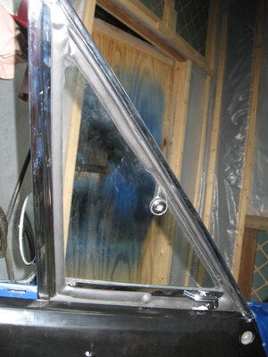

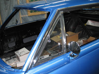

Here is some pic's of the vent window with the new chrome part's. But did have to tap out the bolt hole at the top that holds the front arm in the door. It was not American thread. Also had to make the hole larger in the arm and grind down the raise part around the hole. Thing's just aren't the same with after market part's. But have to make it work. Also got the hood finished painted. Going to put the window in the door. Read that you can separate the frame at the top of the vent window and pull it out enough to get the window to slide into the channel. So here is some pic's. IMG_0101 (1).JPG IMG_0103.JPG IMG_0102 (1).JPG
Just want to say it was not easy. So any one buying new door's beware of the bolt holes not in the same place as the old door's. Have found this out the hard way even the pillar post are not as the original. So had to enlarge holes so the door would adjust rite. So now you know why the body shop takes so long. Test fit and take it off. Adjust every thing and fit it again. :BangHead:
