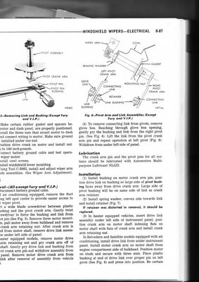

Hi Dave: Here is the picture regarding wiper arm post grommet/gasket position and maybe more enlightenment per PM today.
Hope this helps...
