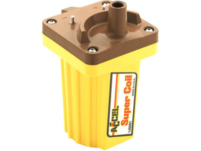

4A4934E1-ADB9-4942-9064-5C899216C934.jpeg What was it in the day with the new ACCEL 40k volt coil? Had to add an extra ballast resistor in series with existing to lower point voltage down even more. Must of been something to that, never had a misfire with one of those.
