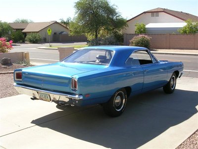

This is my other set up. 225/75r 15 on 7' cop rims so they can be rotated. Still a little skinny
