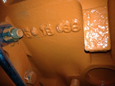

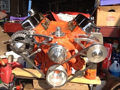

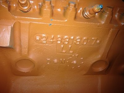

Well alittle update. I decided to pass on the 440 for now. But while I was on spring break two weeks ago I bought a 68' 383 and 727. I tore into it a little looks like it has a forged crank, 906 heads but mostly stock with about a grand in March billet parts :eek: . I'm wondering whats the best way to go with this engine to get some power?
Btw: When looking at Distributors, RB ones will fit fine on B engines right? One of those things in case I ever get a 440... oh and I want an electronic one over a manual, correct?

Sorry the distributors are different in length. The cheapest way to get power is a 440, but that said you have the option of more stroke for more displacement or keep the stock crank and build a high rpm 383 which I like. More ideas will chime in

Thanks, for some reason I though that a RB distributor would fit both RB and B blocks. But a B distributor was to short to fit a RB block.
Here is what I am tossing around my head. From what I am guessing it's a forged crank and if the bottom end is in good shape and can handle the power. To build a strong top end: Aluminum heads, valves, rocker arms, headers, intake, cam and carb. Then later on build a stroker short block that can use the parts.
