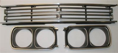

What is the grille/headlight bezel suppose to look like
nicanor
Jul 26, 2011
286
I just received the grille and headlight bezel from Goodmart industries and it is almost all black except around the headlight rim.
The grille really has no black on it at all. What stock appearance should the grille and headlight bezels have.
Thank you,
Barry

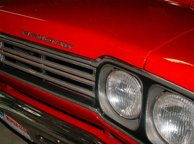

nicanor
Jul 26, 2011
286
Thank you for the picture Droptop. I see all the black in the headlight bezel, but from the picture, I can't tell if there is black on the grille.
Thanks,
Barry
glhcarl
Sep 12, 2008
408
In the picture below you should be able to see what is painted what. If you want more pictures tell.
Jim S.
Aug 3, 2009
1,798
White Bear Lake, Mn.
That Dark Argent paint has gotten really hard to find. I know some places say they sell it in rattle cans but, it is just not right. I had some mixed up years ago. I have to do that again someday just has not been a priority lately. You basically take the light argent formula and add black to it until it looks right.
http://www.mymopar.com/index.php?pid=54
A old thread about the paint and grills..
viewtopic.php?f=9&t=2950
