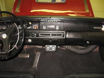

I just have 2 mechanical gauges,oil psi and water temp,I want to do the bypass the ammeter and add avolt gauge,I tied my oil psi in the back of the block on the other plug next to the dummy light sender and the water temp in the top of water pump housing,stock temp gage is still hooked up.

no, the factory temp gauge sender is in the front of the housing. I still use both on mine. same with the oil gauge/idiot light.
