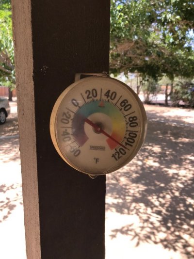

LOL looking at the thermometer just reminded me I have a defective one. I put a new one up this spring and when the weatherman said it was 115 or so I would look at the thermometer on the patio and it was only 110. After several of those daysI put it on the sidewalk to super heat it and it sticks on 110 and won't go up. Maybe I should keep it LOL
