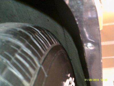

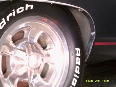

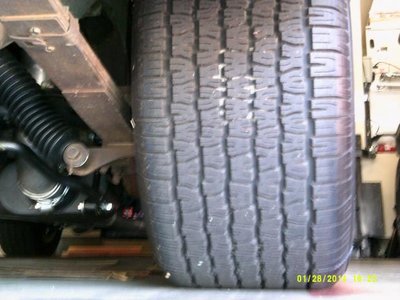

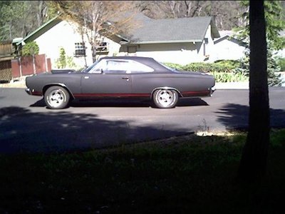

I have 15 x 7" {BS ?} {true mounting surface is 6.5"} front with BFG p245/60/r15
15 x 9.5" {5.25" BS IIRC} {true mounting surface is only 9"s} rear with BFG p295/50/r15
Halibrands {knock offs} made by Edlebrock some 11-12 years ago
they have a really thick wheel lip, is the only thing I don't like,
I don't think they even make them anymore either...
I like the late 60's early 70's vibe it gives off...
Different strokes for different folks...
I personally like a wider tire on the rear, a little LA rake/nose down slightly towards the front
I live in the Sierra mountains, allot of really curvy & some really rough roads too, need a little sidewall,
I like my car to handle as well as look good standing still, in the corners, going straight down the road/track...
sorry photos are old too...

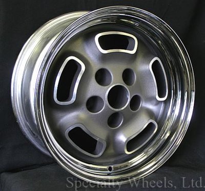

I do really like the Kelsey Hayse wheels thou...
