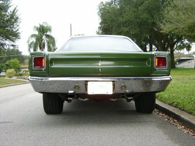

I'm running the 15 x 7 Magnum 500's w/ 4.5" backspacing up front with 235-70R/15 BF Goodrich Radial T/A's and 15 x 8 Magnum 500's w/4.5" backspacing out back with 275-60R/15 BFG Radial T/A's. Everything fits like a glove and the 275-60/15's 11" tread width really fill the wheelwells. The reason I went with the 235-70R15 tires up front is because they are the same height (28") as the 275-60R/15's on the back.

Collin: I've seen and ridden in John's (MCMopar) RR. If you want the Road Wheel look with wider rims and a larger rubber combo - just follow the pattern that he has set forth for you. The car has the perfect look and stance for a street car with factory-style wheels. He's already dialed in the backspacing (I used the same when I ordered my Halibrands - 4.5" on the rear is PERFECT for 8" rims) for you so you cannot go wrong. The look is stunning... :cents:

Here is one more pic from the driver's rear 3/4 side:
