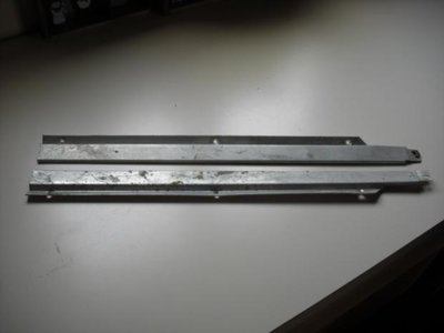

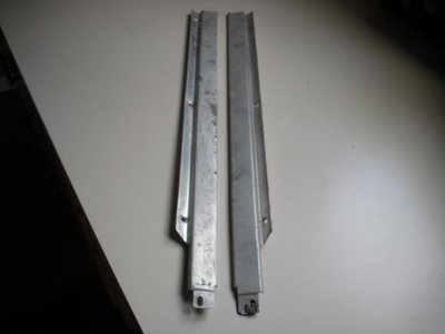

Found these two trim pieces in my box of parts and I think they are for the rear carpet not really sure so does any one have a picture of where they go.
help this oldman out.:lol::lol:

Bill, that is exactly what they are. They anchor the carpet at the bottom of the rear panels down by the sides of the back seat. The front part of each piece slides under the rear of the sill plates and is screwed down at that point together with the sill plate. Sorry, no pics.
