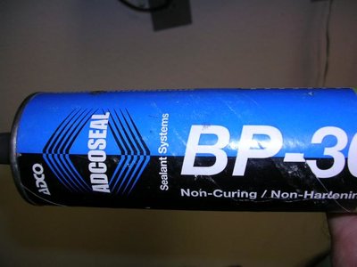

use something like this in the bottom corners about 6" in each direction before the gasket
