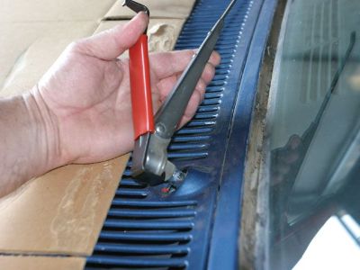

82
You Need One Of These !!
I have one of those. It was on that big tool trailer at Carlisle and just a couple bucks... I couldn't pass it up.
