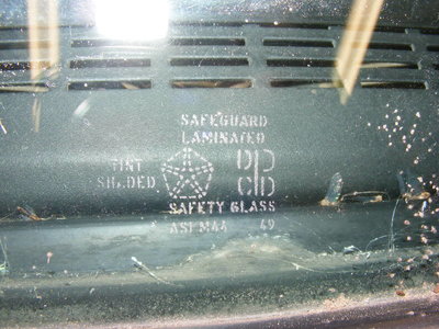

OK.. its a little difficult to remove a Roadrunner windshield. Years ago, I had a windshield guy show me a few tricks of the trade and I've had pretty good luck since then.
First, and even though I'm not a "numbers" freak, I took a pic of the date code because you never know.

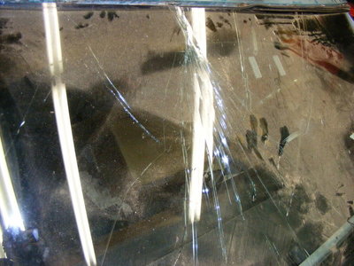

Then you get in the car and lay on your back and gently push against the windshield with your feet being careful not to......
crack it... :o
I do believe you use a tool to cut the sealant first, Same as the back glass. Mine came out ok but it has rock chips in it. :rolleyes:
