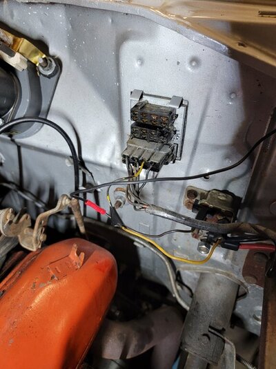

Can someone identify the wiring harness color wires and connections in these pics. 69 engine wiring harness with ecm and upgrade alternator hookup.

duel ballast resistor and voltage regulator. oil sending unit. but me i would look at a wire diagram like 1970 to be sure.

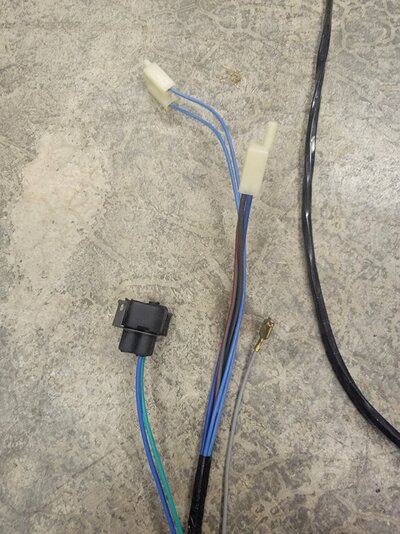

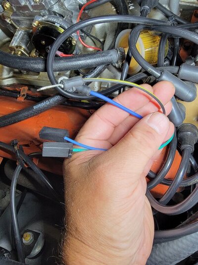

Ok I'm stuck here. I have most of the year one wiring harness in. I have a dark blue and a yellow/black wire. Do these go to the coil? I also.have a blue and green connector that I guess one or both that go to the alternator? See attached pic.

Hey Russ, at the risk of sounding like Cpt. Obvious here, doesn't Year One offer a wiring diagram?

Wow it must be small. The new harness plugs into the other half of the existing firewall connector, right? Then it should be the same as the old harness. Some of the colors may have changed. You should be able to use the factory diagram I sent to the "no spark" thread. It is a PDF, you can blow it up.
7,705
Ordered a color chart form Classic industry. On it tells you 440 383 or 426. That chart is valuable with in itself. Have mine taped to the lid on my toolbox. It is printed bold enough that you can read it. Keeping the old wiring harness is valuable in tracing out the wires. Only had one or two wires that changed color in the under-dash wiring. I called the company that made the wiring harness for year one. Those guys were very helpful. Think the wiring was from S&H if my memory is right. Your almost there Russ.

I ordered a big color diagram fron classic car wiring. I believe its 18x24

Got my wiring harness changed. I've found the other problem and it's the inside part of the bulkhead. I think once that is changed I will be good to go.
