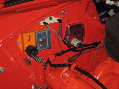

I did a similar cut/splice/repair job on the harness for Tam's Swinger. I did not care for the original '70 Dart dash and wanted factory A/C controls in the dash also. I swapped a '71 Duster dash in it, and then used the best sections of each harness to get what I wanted. Here's a pic of the finsihed product if you guys are interested - ignore the paint chips in the dash frame - they've since been repaired. The car came back from the body shop with the windshield and the dash frame installed and we buggered up the dash frame a tad getting the A/C & heater unit back in... Lesson learned on that installation sequence...
