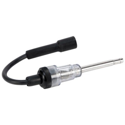

Grab one of these. Makes it easy. Until you know whether or not you have spark at the plugs you're just grasping at straws...
