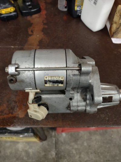

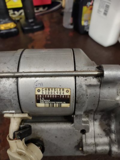

I pulled the starter and it is fine. Electrical some where.

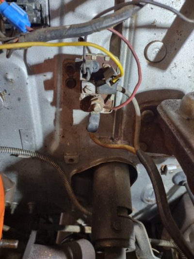

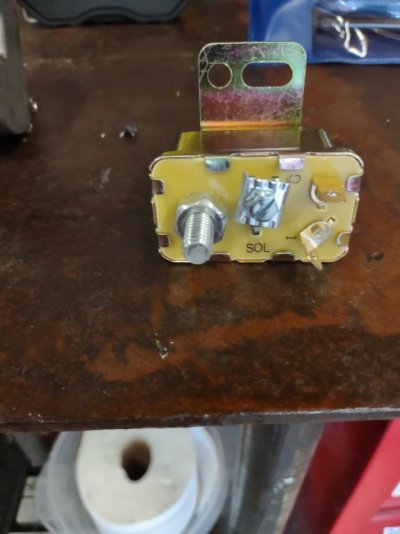

Update:. So I found the cable going to the starter was in bad shape. The starter relay I replaced and I found the ground was in bad shape. I ordered a new positive cable. I now just have to reinstall the starter and the connections and I should be fine. Yea that stater is too much fun lol.

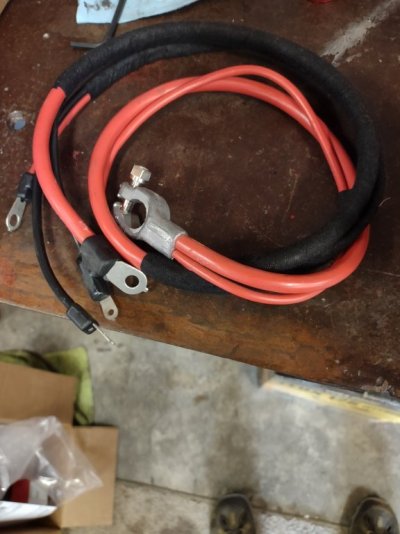

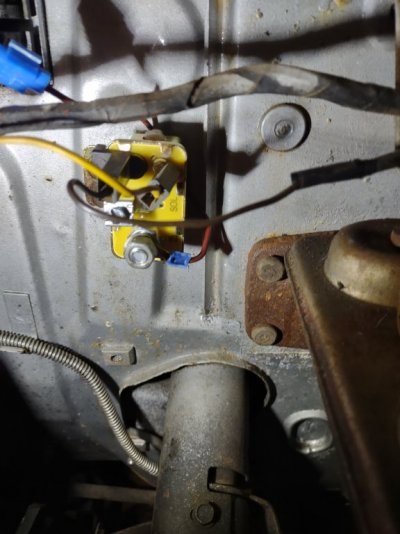

Update. New positive battery cable to to the battery and starter regulator. New starter, new battery. Hot on each. Won't even turn over. Could it be the ignition switch?
Help lol

you need to check voltage from switch to starter relay then voltage at the starter from the battery then check the ground from the neutral safety switch to starter relay.
look on you tube on how to do a voltage drop test that will show what is wrong.
i see a scotch lock on a wire those are no good in wiring as it cuts the strands of wire and make resistance in the circuit.
