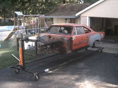

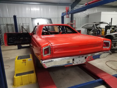

Agree Russ, it can take a long time! First pic: mid to late 90's... last pic: about a month ago...

Plybeep68, yes tubbed... 33 X 21 X15s on back....
Russ, thanks! Keep up the good work, I really like that blue!
Bad ass car. If it were mine, which I know it’s not, I’d black out the fuel cell or is that a metal fabricated housing for the fuel cell, regardless, hard to spray bomb freshly painted cars with black but that is one spot I’d hit for sure.

Hi Roadtrip, thank you. I've thought about that as well. It does stick down quite far. It is a fabricated area in the truck that the fuel cell sits in, I went with a 32 gallon cell. Had I known it would stick down like that, I would have went with a smaller one. I may just get some black vinyl wrap to put on it and see how it looks, much easier to go back if I don't like it.
